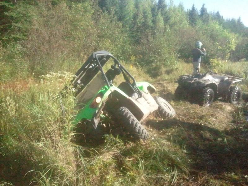

Ok here is the deal...was driving late at night...decided to take a powerline because it was shorter..haven't been on it in a few years..made it a few feet I think then I sunk to the right (pics to follow).
Left the bike there over night, came back with a few quads the next day and got it out. It was almost laying on the right side. When I got it out it and upright smoke started rolling out of the exhaust, which I figured would happen...that stopped after a while.

Here are some pics...any advise will help!
[IMG][/IMG]
[IMG][/IMG]
[IMG][/IMG]
