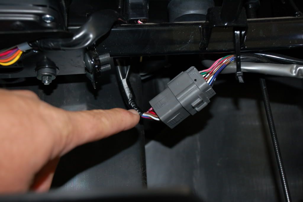

I spoke to Kawasaki today to get an idea of when the units will come off of backorder…they are scheduled to be available in April. These units are plug and play, the pigtail exist behind the dash and will plug right into the new unit.

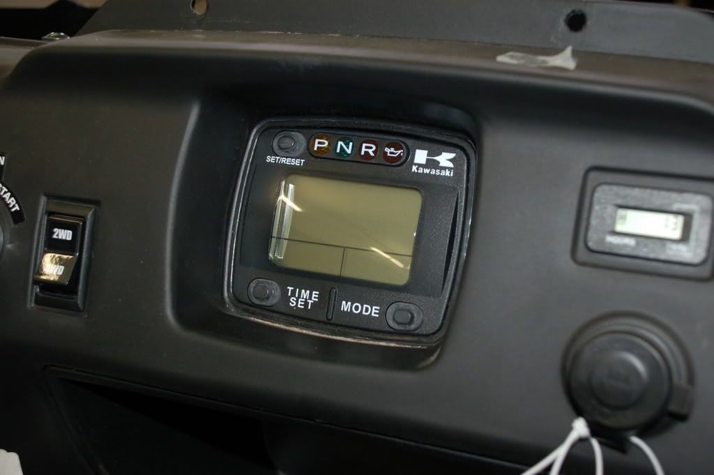

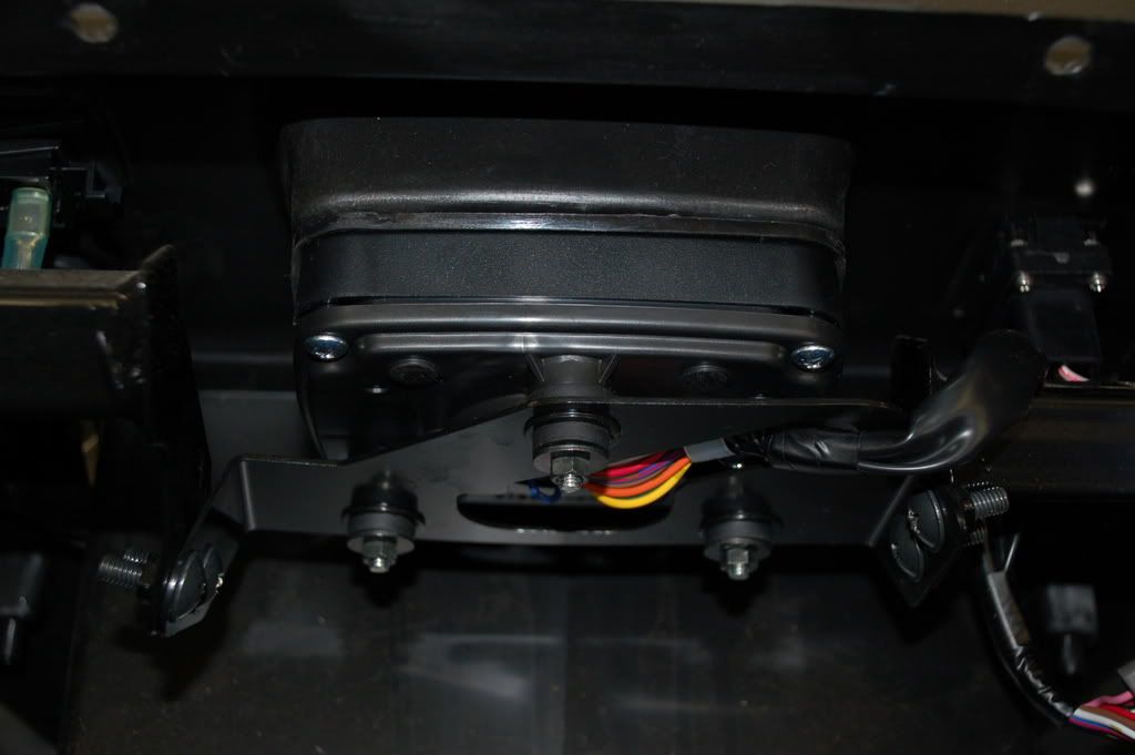

Heres a couple of install Pictures the harness end is in the small black plastic bag also when installing the rubber grommets spray them with some soapy water It makes them go in easier...
